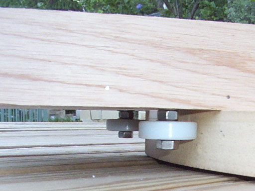

Ok here's some pics, I made mine a little differently in that I used a thicker base plate 'cause I've got a great huge lump of a (3 1/4 hp) router and I didn't want the jig to sag in the middle under the weight, I also made it wider to accomodate the router base plate, I just added the difference to the other dimensions. Also the wheels are a little larger in diameter 'cause they were cheap and suitable and right in front of me when I was in the hardware store - they were designed for sliding doors. The jig is a little rough by some standards 'cause I'm not one to make pretty jigs, if it works well that's good enough for me, especially if I'm only going to use it a couple times.
As you can see I don't have the radiused rails installed (or even made yet)but you can see where they're supposed to go.
Here's a pic of the underside, you can see how the wheels are placed in relation to the dish.
Here's a pic from the side showing how the wheels index against the side of the dish. I'm using 32mm mdf which is about 1 1/4" in the old money.
Hope this makes it clear, if you've got any questions ask away.

One thing I forgot to mention is that if you make it wider to accomodate a wider router base, then you've also got to make it longer at each end as well. What I did was to draw it all out on the base before I started cutting and routing. Then fit the base over the dish blank, put the router on top and started looking for problems - that's when I picked up the length problem. Also if you beef up the base you have to check that your router will have enough plunge depth.
